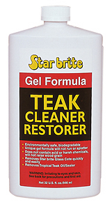

nemo napisal/-a:..., nato zribam z Stabrite Teak Cleaner-jem in nato nanjo nanesem se Teak Brightner.
Ali mi lahko poveš kakšna je razlika med Teak Cleaner-jem in Teak cleaner and restorer-jem? Oba od Starbrite. Hvala za pomoč!
Overview of Gel Formula Teak Cleaner/Restorer.
Great for doors, cabinets and vertical trim
Especially effective for removal of Tropical Teak Sealer. Also removes Star brite’s Instant Glass Cote. Safe formula does not contain acids or harsh chemicals and won’t raise wood grain. Gel clings to vertical surfaces, so it’s excellent for cleaning teak doors, cabinets and trim work. Quart.
* Won't raise grain of wood
* Non-runny formula beats others that simply run off
* Cleans without acids or harsh chemicals
* Versatile cleaner also removes Instant Glass Coat and Tropical Teak Sealer
* Quart
